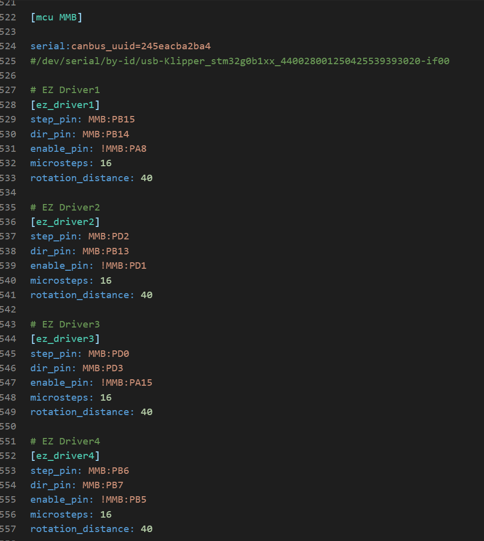

What are you doing with the MMB board? Are you using it for an ERCF system?

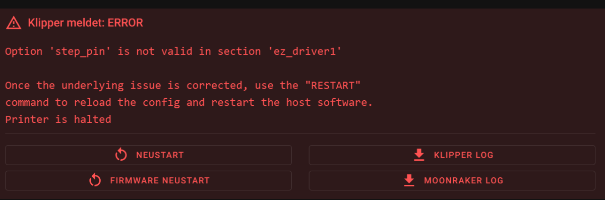

You are using the default MMB config which is not set up for any machine. It is really just a reference for pin names. The printer is showing an error because the step_pin is not defined as part of any klipper stepper motor config like [stepper_x] or [extruder] for example.
If you are using the MMB board for an ERCF there is a sample config on the github.
