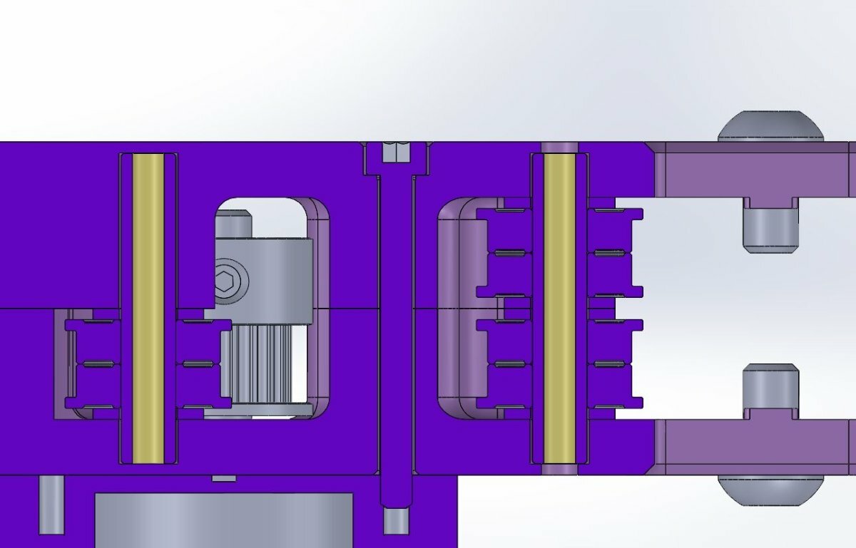

Because I don't want to process metric screws directly in plastic as long i can avoid it and I want an axial fixation for all axes i changed the design of all affected parts.
Example (here the axes are brass tubes, the screw is not shown).

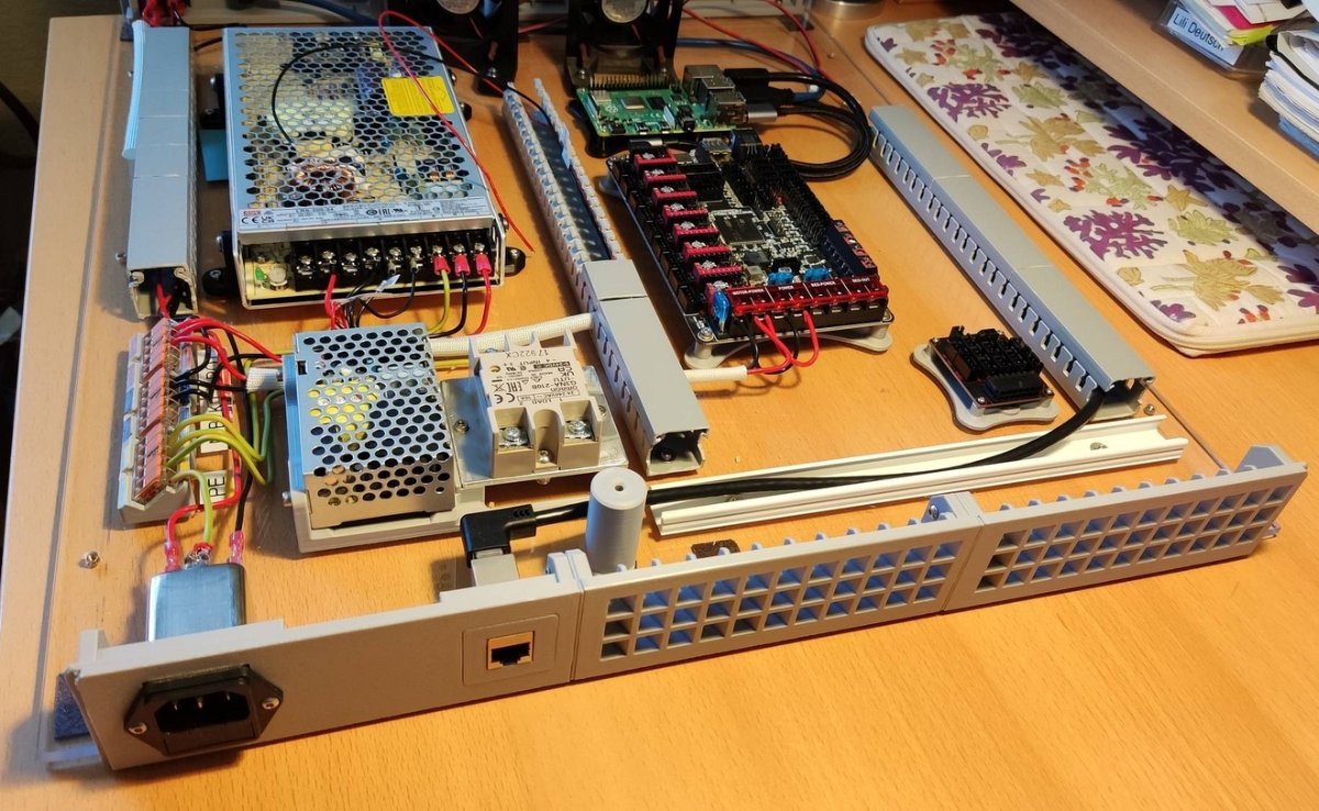

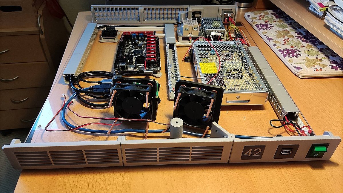

I  realised a different kind of elektro compartment. I changed my opinion and did it below the bed, as usual, but a "reverse" version and on a plate.
It should be a little bit more closed than the original, and i want the power switch at the front.

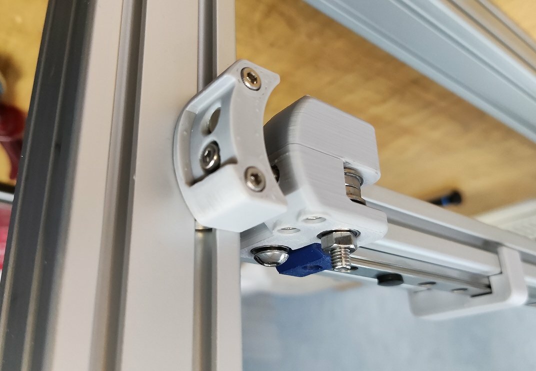

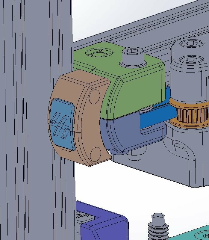

And i wanted the keystone brackets without play/gaps so i made two-part brackets.
