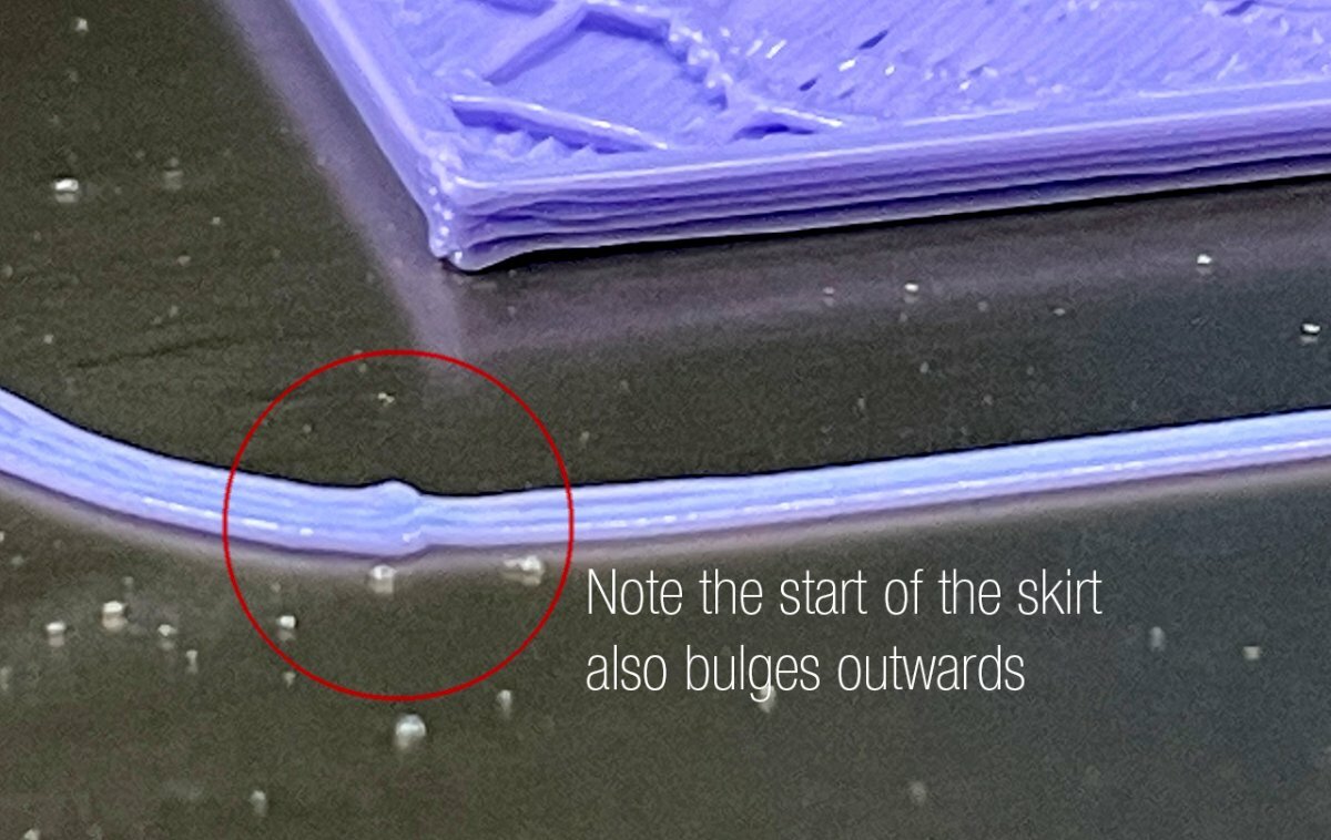

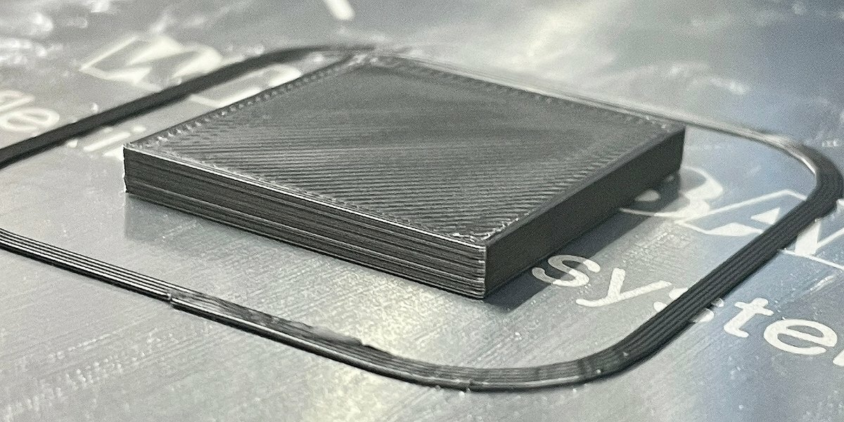

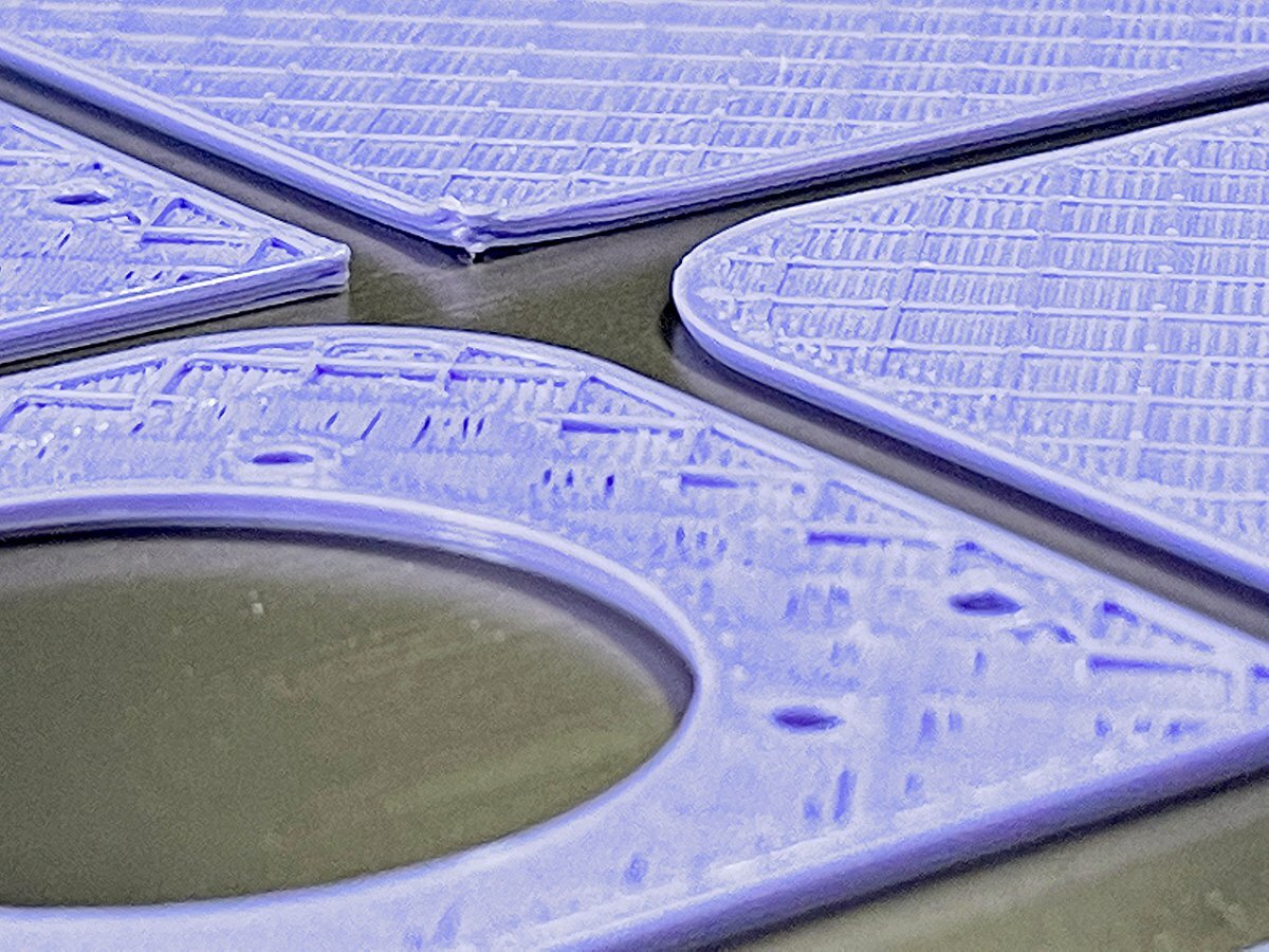

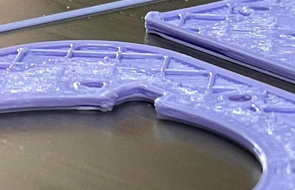

Hi, I'm not sure how best to explain this, but for some reason my newly built Voron extrudes just a little bit too much filament at the start of a path, and sometimes at the corners of a model. Basically it bulges the corners of the model enough to make it appear like the model is warping upwards (because there's more filament at those places than on the rest of the model).

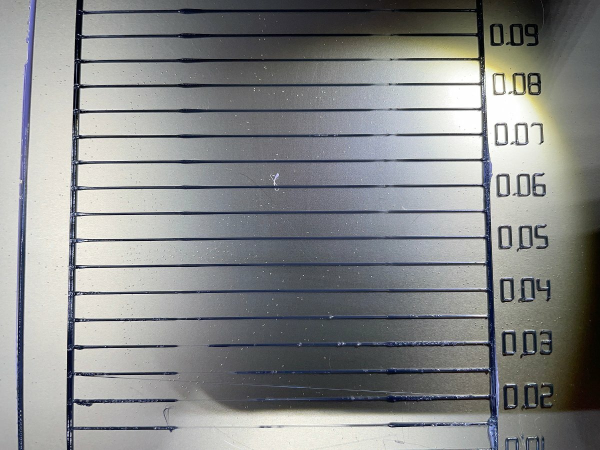

May be your answer. Also see Andrew Ellis discussion on this. He has two methods in his tuning guide. I ended up using both to ge the results I wanted.
It seems like that was it (pressure advance). Had not known about this before and was already going through Andrew's guide since it is a new build.

But that failed miserably. Of course when trying this method I commented out the line in the printer.cfg and it didn't work. The prints were horrible - missed filament at the start of each layer, corners missing filament, infills fell short of the edges, etc.
