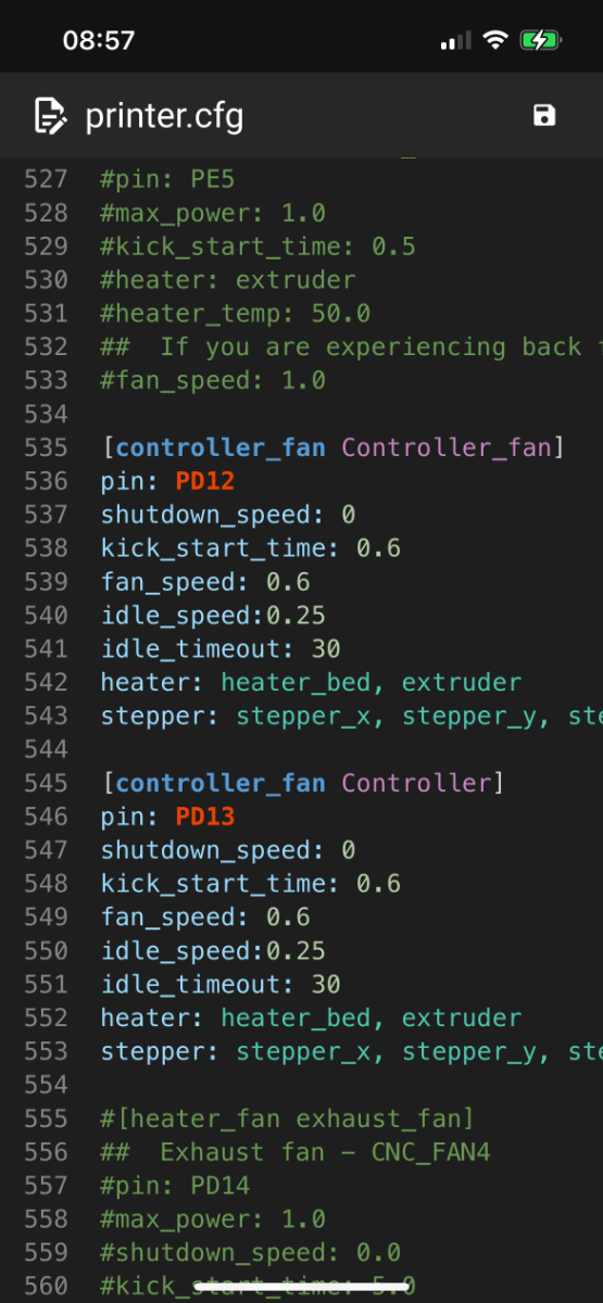

The issue I'm currently having is trying to slow down the controller fan speed to make them a little quiter, they run at 100% when activated.
In the printer.cfg I have tried decreasing "fan_speed" to a value of 0.5, save and restart but they continue to operate at 100% as indicated in the Mainsail GUI.
[controller_fan controller_fan]
##  Controller fan - FAN2
pin: PD13
kick_start_time: 0.5
heater: heater_bed
fan_speed: 0.5
Any comments as to what I'm doing wrong, or suggestions as to how I can slow down the speed of those fans?
