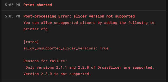

So, I just upgraded my Orca Slicer to 2.3.0_RC. Sliced a part and set it to the printer (RatRig V-Core 3.0 300) and here's the message I got.
So, I copied the recommended code, pasted it into my printer.cfg and re-sent the file.

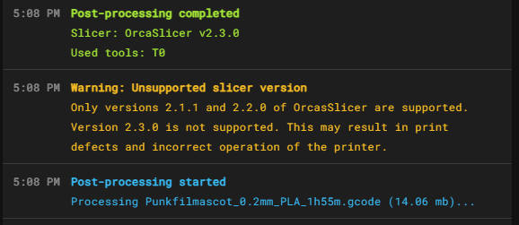

Then I got this message...
I do have a number of updates pending so it will more than likely clear itself up once Orca officially releases 2.3.0 but I found it interesting that they even care what slicer I'm using. I guess somewhere they're using some hooks from Orca and some feature might not work given it's a new version.
Anyways thought it was interesting enough to post.
