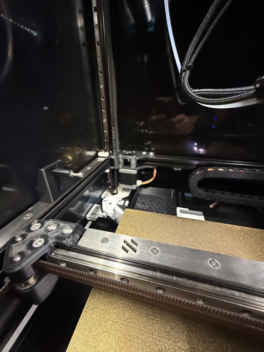

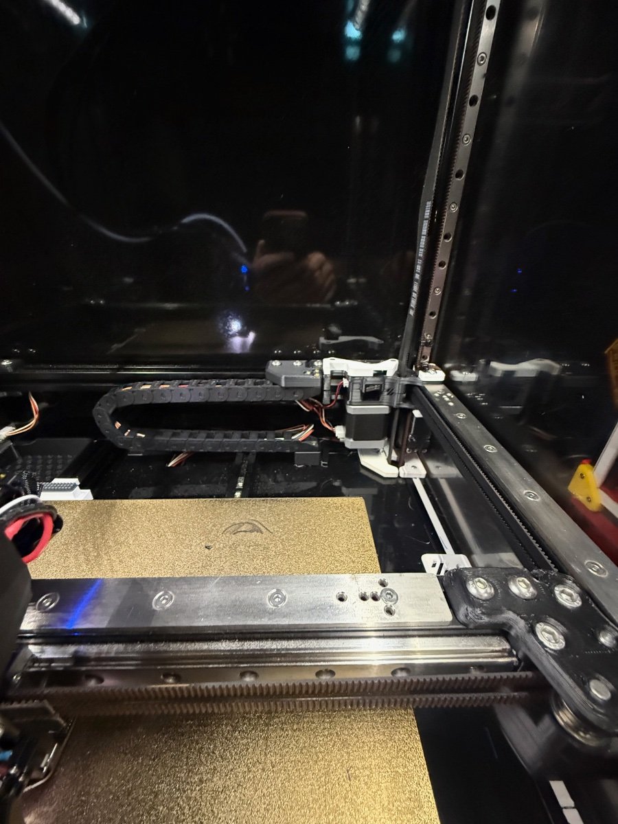

  6. Installed the horizontal Z-Chain. Had a look at a Z-Umbilical but the chain install was easier.

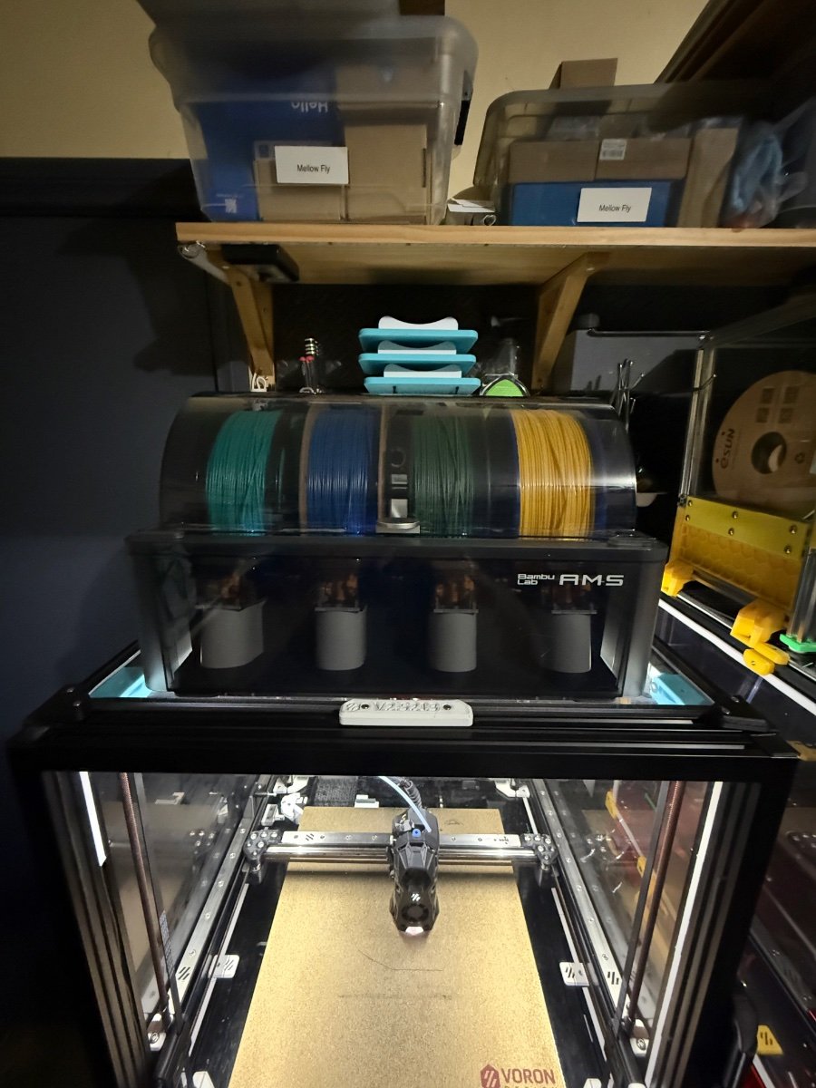

  8. Placed the OAMS (Open AMS) onto of the printer: Going to run a couple of extrusions across and mount the OAMS to those.

IMG_1008.thumb.jpeg.b6a100ac16a0f785a9a4d3f237147b61.jpeg         IMG_1009.thumb.jpeg.6a6b8ad8206b4d319f180a92f8d7f107.jpeg

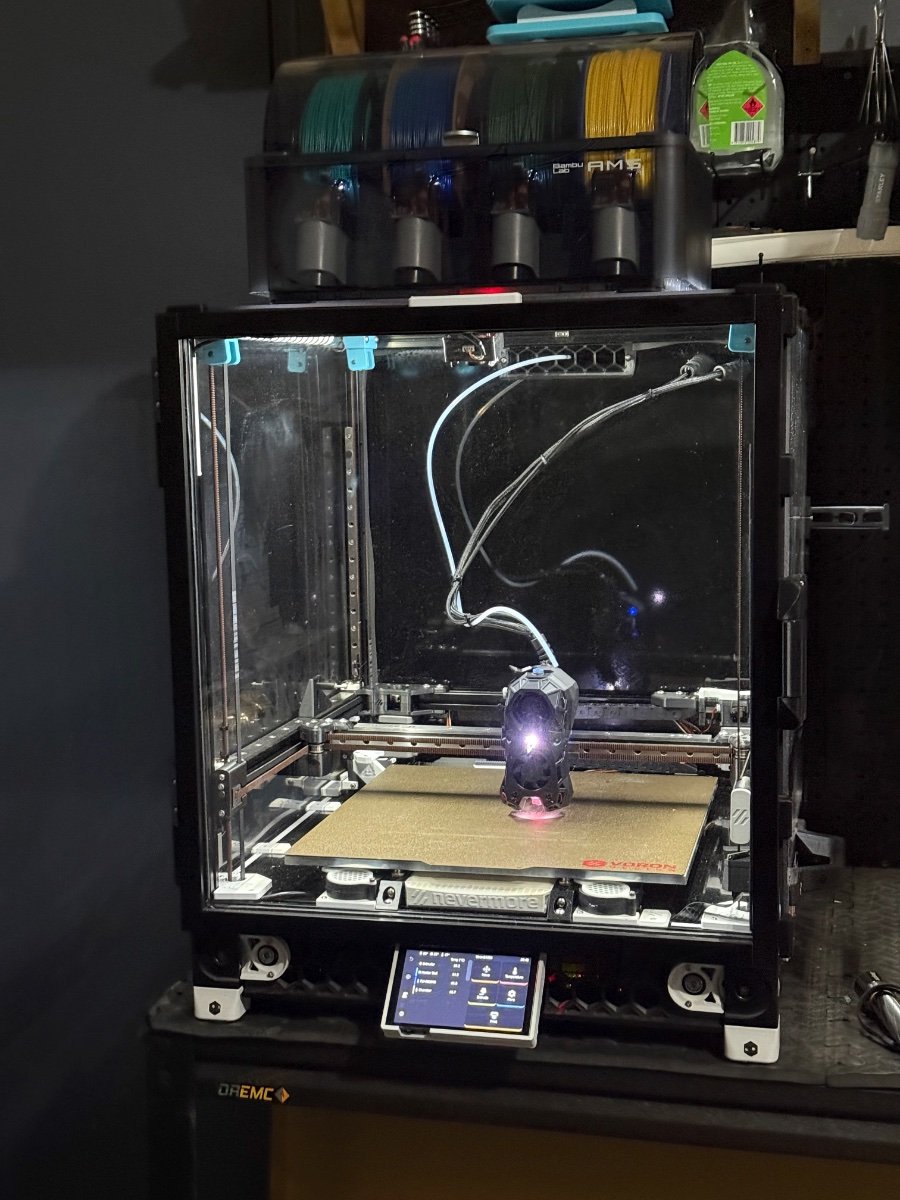

Here she is:
IMG_1005.thumb.jpeg.1c5534e396ae67cd7ddb260ebf5de6a1.jpeg     IMG_1007.thumb.jpeg.06a10efbe9ee456881e796ea37859011.jpeg

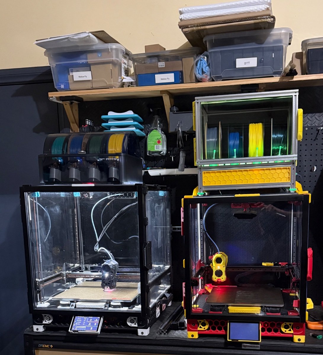

And for size comparison the OAMS and Boxturtle side by side:
