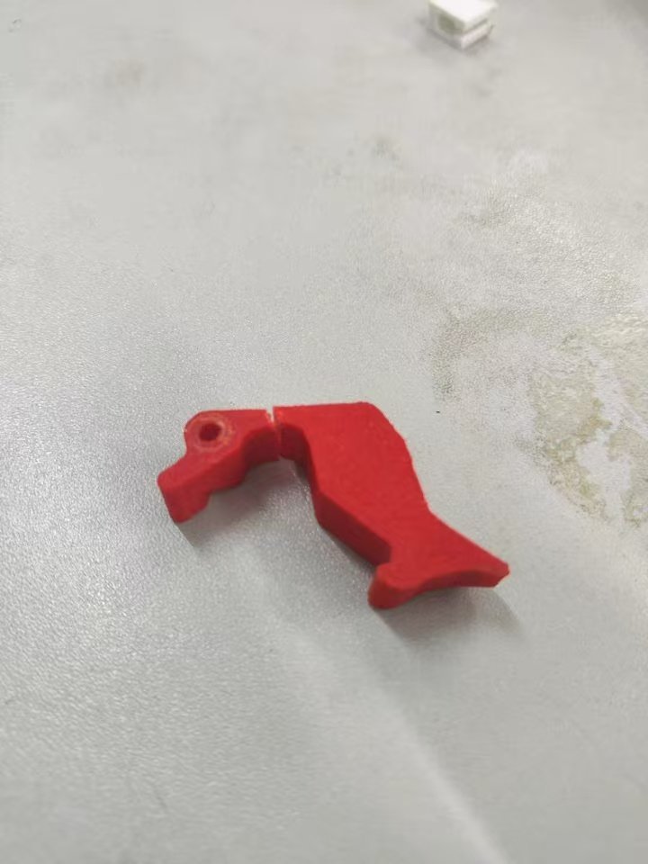

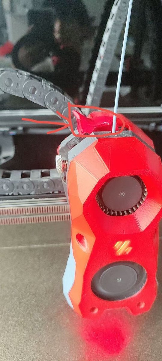

Also it looks like the broken part you have there is an early version, which is maybe why it broke. The newer version is thicker in the area that broke.
I can't remember what other changes were made since that part but it is probably worth reprinting the whole CW2 so that you aren't mixing old part designs with current ones.
