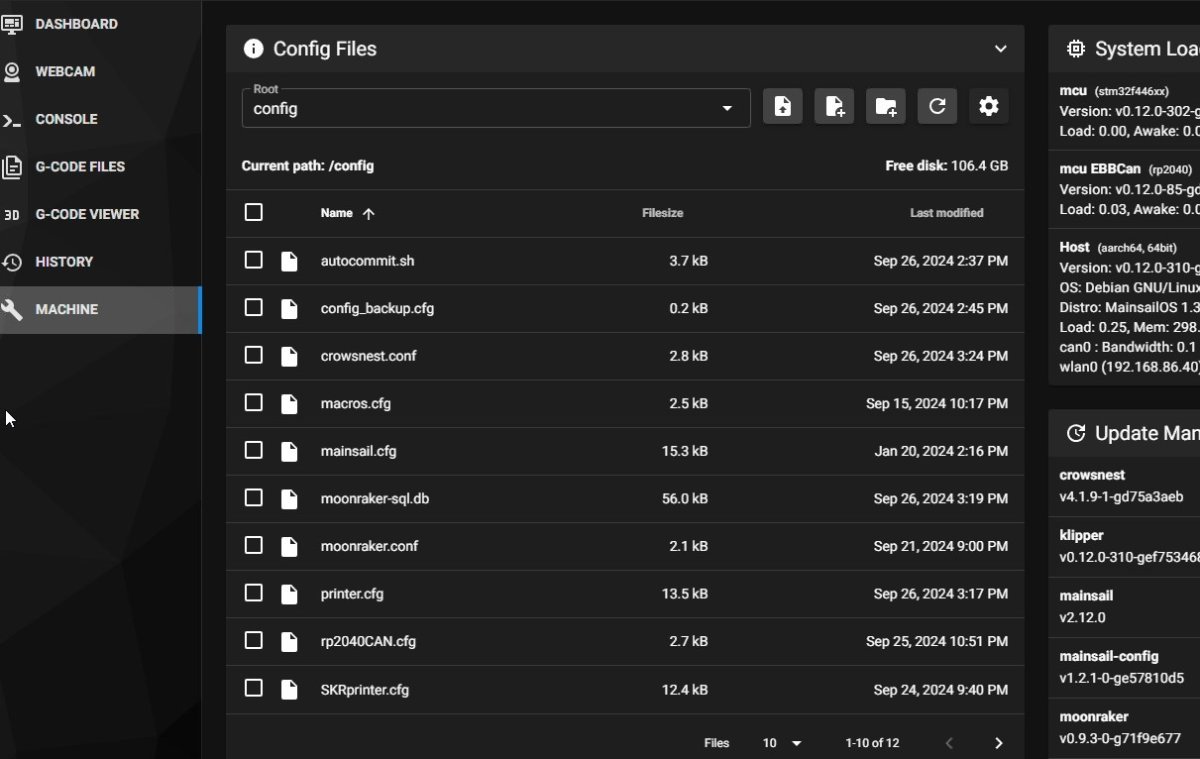

Here are the files listed in the web page, they look in tact, but show up blank in the editor.

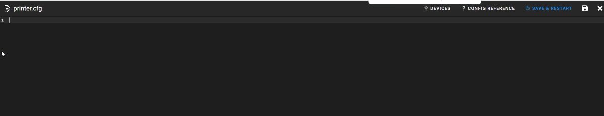

This is what I get when I try to edit the file in Mainsail

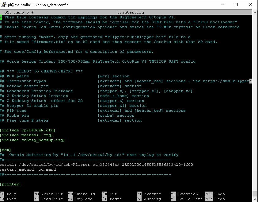

here is the printer.cfg in nano

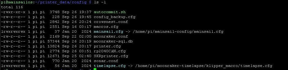

I am guessing that somehow the permissions on them were changed so the webpage doesn't have permission now. attached is a pic of the file permissions, does that look right?
