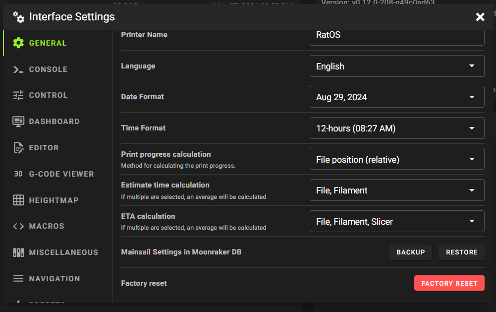

Agree that something got corrupted. There's a feature built into RatOS that lets me restore moonraker or do a factory reset. I have to do a bit of research before I go clicking stuff not knowing what its going to do beforehand. I will report back...
1 hour ago, 5twenty said:
Good luck, when I implement "restore" in software it was usually asked for, and the caveat was always that the user "backup" first. I always suggested an auto-backup but was always dismissed. (guess what? they always wanted it afterwards).
I'm of the opinion that that option requires action beforehand - as in you might have had to backup first.
Yup, I share that same opinion.
RatOS is a very different animal than Voron Klipper. I mean not that it uses different commands rather, it's highly optimized for specific hardware and uses a lot of lock read-only config files. On my Vorons I would probably SSH into the Pi and use Kiauh to remove and re-install moonraker (at least I think you can install/uninstall it with Kiauh).
Right now the printer prints fine and having a webcam or lack thereof is really just a convenience item. Once I get back from Florida in a few weeks, I'll do a deep dive and get this resolved and TBH, it's not really that difficult to reload RatOS from scratch. Just weighing options at this point.
