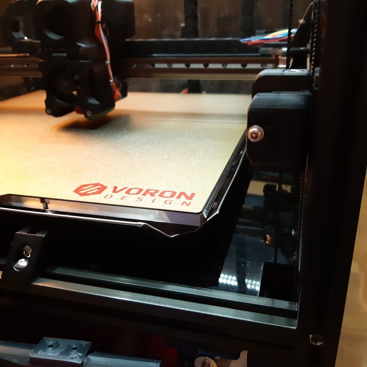

I bought some insulation for this purpose. I saw a video that suggested it with Voron 2's because the plastic sheet on the bottom warps at higher temperatures. However, I have not installed it yet and have not seen any other detail on this subject. I'm curious if anyone has experience with this as well.
I have installed the neoprene foam with aluminium foil insulation layer on my Voron 2.4 because of the bottom plastic sheet warping. Once installed the area below the heatbed is MUCH cooler and there are now heat issues below the heatbed at all. I also found that it heats up faster, retains heat better. I would do the same again in future.
