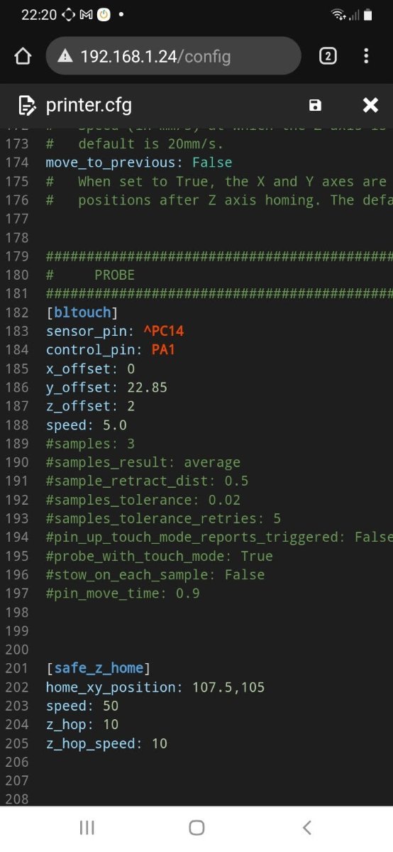

I printed the shell and tonight tried it with a CR-Touch connected to SKR MINI E3 V2.0 and I could never get it to probe.
CR-Touch would blink red and then it would change to blue during home but the probe never extended.
Using the same configuration I tried it on a BL-Touch and the BL-Touch worked as expected.... I wanted to make sure my configuration was correct.
I even swapped wire harness and still the CR-Touch wouldn't probe.
