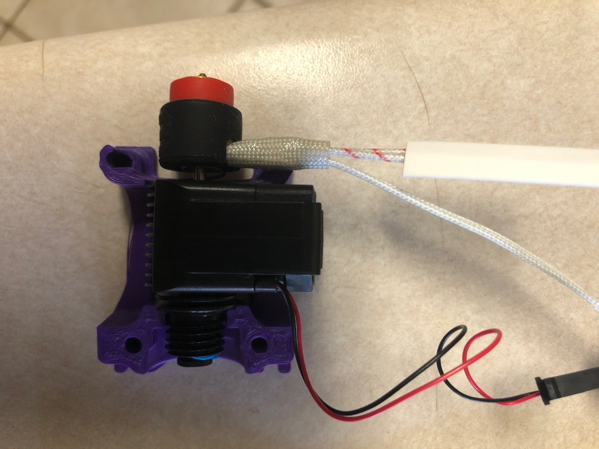

Got the hot end and clockworks built. Right now I’m using the dragon high flow. I can’t seem to get the revo micro in the parts, but I’ll keep trying. As soon as one becomes available I’ll get the v6 revo if I can’t get the micro to work. Note to remember to install the silicon sock before you put the hot end completely together.  Waiting for wiring and connectors to show up so I can finish up the wiring using wagos.  Then I can flip the printer back over and get to work with the cable chains and wiring.

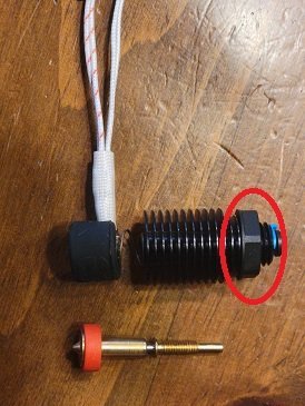

What seems to be the problem with the Revo? One small detail that is pretty subtle on the SB mount is you have to take the big nut on the top and flip it upside down from how E3D ships it to fit the mount.
As you found, yes that bitty little fan comes off. The 4010 fan in the SB front plate replaces it.
You need to reinstall the nut, just with the flange on top. It fits into that open space at the top of the mount. I'll take mine apart later today and take a pic.
It's no problem, and makes for a good example of a) how well thought out the SB is, & b) how easy is it to tear down and reassemble.

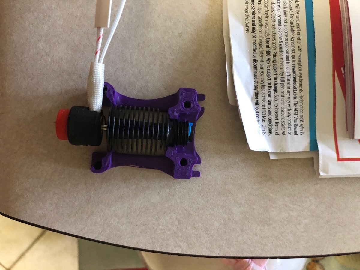

Here is my Revo as it sits in the holder.
FYI, it took 6 screws to remove to get to here. I didn't unplug anything and forgot to unload the filament. 😉 About 8 minutes from power down to power up, including taking photos.

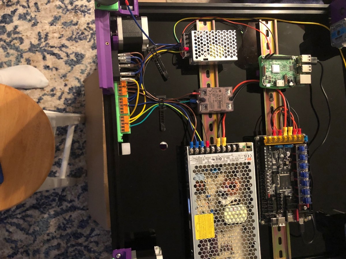

Well. Backed up but didn’t punt. Reworked my wiring and neatened it up. Cut the wire harnesses and used wagos for the high voltage. It looks better now. When do I need to start worrying about installing firmware?  Also not sure if you can see it in the pic but there is one wire of the wiring harness on the high voltage side with a wire left over on the 5v side. Going to look at Nero’s and Thomas videos tomorrow to see if I can figure it out. And still need to get the sat wires up and I’m going to go ahead and install the bed so I can get that wiring in there.  But I’m happy with the progress I made today with help from all of you. 659EF5B8-D14E-40D0-909B-5208E1DD9198.thumb.jpeg.f449a77f78853879f3c43f2e78ec726b.jpeg
Looking good. When I was wiring up my power, I was directed to just run pairs of +/- wire from the Meanwell to the Octopus instead of the jump loops. The reasoning was to split the power across pairs of wires rather than all through the one, then daisy chain off it. Seemed reasonable to me so I went that way.
