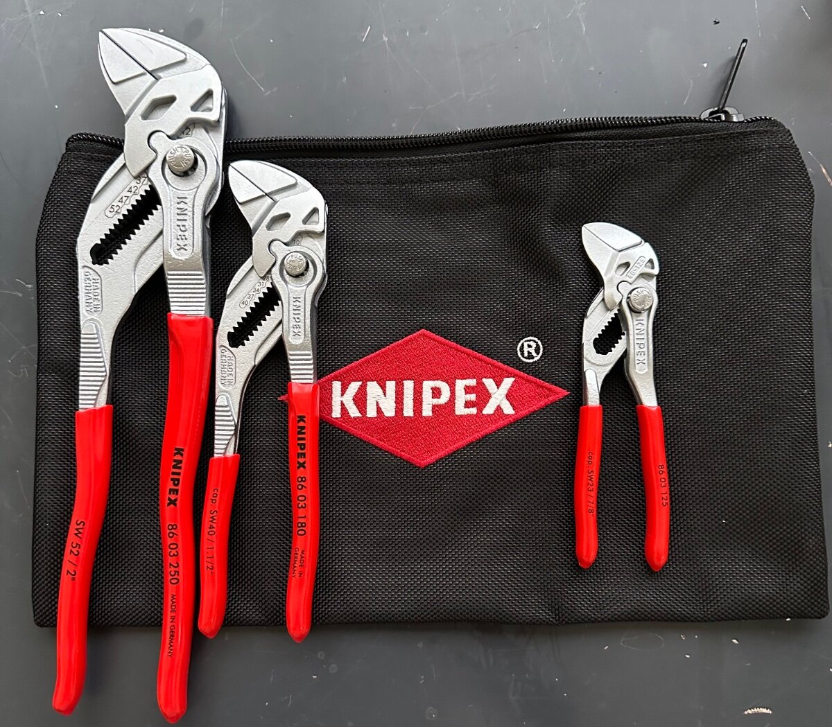

Well another to add to the list are the Knipex Plier wrench for inserting neodymium magnets into the printed parts. Saw this on Steve's builds and @Buurman re-enforced their use. So early Xmas present to me. Will certainly try them out when I get to installing the Voron Tap.

Those Knipex tools are awesome.  Expensive, but worth it.  Buy once, cry once.

I use the small almost daily. not just easy for pushing in pinned versions of bearings, but even use it for pushing in LED's in the SB mini, etc, because its so small and smooth, you are not damaging things easily.. I absolutely love it....

I you bought just one, which size would you recommend ?

I guess a mid size, I now have two, the smallest one and the largest one, together they get every job done.
The larger is just very useful for putting pins into the pinned versions of the mounts, if you use those, I always do.
I guess the 150mm is a good middle ground, but for most things the mini is just fine.

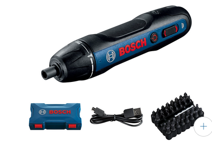

The Bosch Go Professional with push to run (or button) and adjustable mechanical clutch for torque has been one of my favourite tools for my build. And I use it on a whole bunch of other stuff too.
I saw Thomas Sanladerer using this in one of his videos. So I investigated and discovered they're available here in Australia. About $95 AUD. I have one of the small Xiaomi Drivers also, but not enough oomph for the build I don't think.
It uses a usb to charge and the battery lasts for ages. I have it on the lowest torque setting and it's just the sweet spot for the small m3 screws. I hold the driver a bit loose too, which allows it to spin in my hand so lessening the torque more. (It has an electronic brake so stops quite fast) Want it tighter after the clutch disengages? Just manually turn the body and the driver is locked. The torque setting can also be locked to drill mode.
As mentioned, if you push down on the fastener, the tool will start. Alternatively there's a - very sensitive - button on the side. I find that when I pick up the driver it always bursts into life as I've bumped the button. Not a bad thing though.
It uses a magnetic hold for the hex bits instead of a mechanical grip, so if I use my hex drive 3 or 5mm drill bits to clean out holes, I need to withdraw slowly, as the bit will pull free of the device. There's the obligatory extension also for the bit set. (I actually use a Kinchrome bit set instead of the standard supplied one)
It's saved me a heap of time and discomfort. For example, the l-o-n-g 50mm m3 screws that reinforce the R8 tap, with their fine machine thread pitch would have taken forever to insert, with my hand probably cramping up.
Lots of brand x variations out there, I'm sure, but I am happy I spent the $ on this one.
