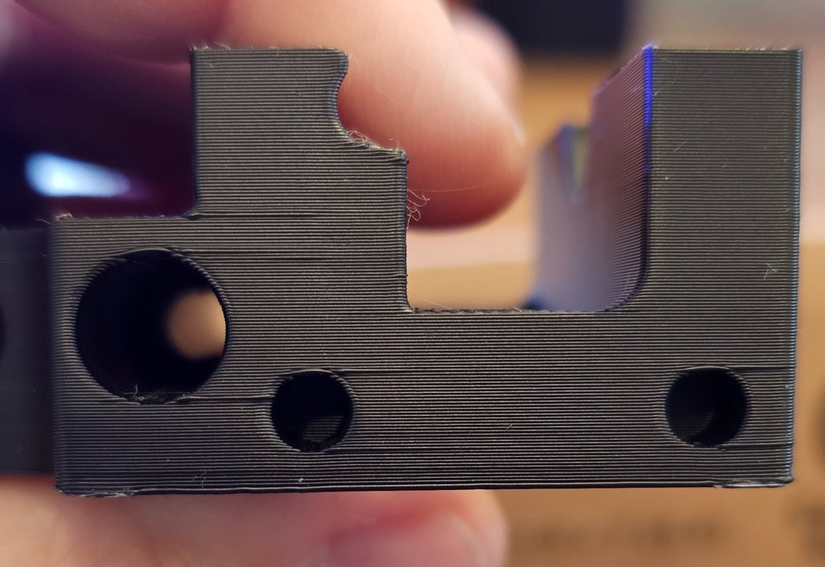

So, If I have calibrated my extruder and I am getting exactly what I am asking for but still have issues with dimensions of the final parts, would I use Rotation_Distance to calibrate each axis?
For example. I continue to have slightly "squished" holes on the Z-Axis. If they are on the Horizontal(X/Y) they are nice and round and symetrical. This tells me that maybe the Z-Axis is not exactly calibrated correctly, and the printer is moving "Up" slightly less than expected. Reading the Klipper documentation it appears that Rotation_Distance is supposed to be the way to tell the printer how far it travels in one rotation of the stepper. I can put a dial indicator on the axis or just print a cube and calculate the correction from there.
Is this the right path to take?
UPDATE: I did go out and do a quick measurement with a ruler and had the z move in 1mm and 10mm increments and it appears to be spot on. Not sure what is causing my "squishy" holes.
This is ejat I mean by squishy. It's not terrible but it is noticeable.
