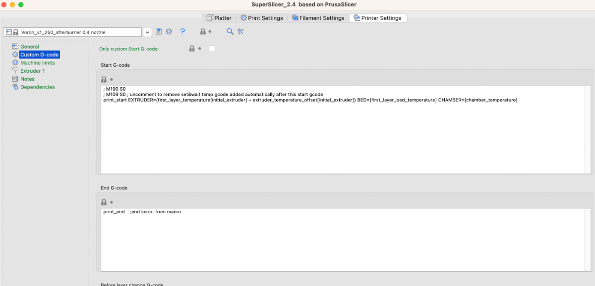

Can you post your PRINT_START/ START_PRINT macro please - may be something in there. Also the line in the slicer GCode section that calls the start of the print.
Not sure the issue is in the gcode as the QGL command causes the same problem.
