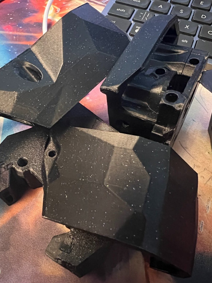

I was reading a post on filiments here and ran across the statement that the eSun ABS+ filament has a lower heat rating temperature and may not be suitable for printing Voron parts?
I got this awhile back and loved the look and way it printed but now concerned that the parts are not suitable for use?
Any additional details on the use of the eSun ABS+ for printed parts?
I can always print them again. 😆 1681166255763621242616194924077.thumb.jpg.f0ae9373cc865da6ec914bb811f55ca0.jpg
