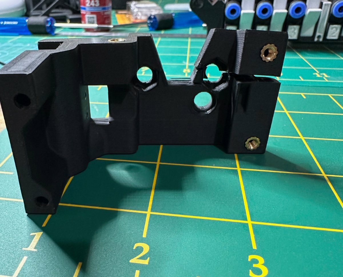

Well this one was not without incident. The bottom blocks are secured by two Nylock nuts (I hate the stuff). The M5 Nuts fit in the gearbox and is locked with another M5 nut. First time around whilst tightening the nylock nuts - the block cracked. Trying to get a small spanner in there to hold the M5 is near impossible.
Finally got it done - all parts fitting perfectly together.

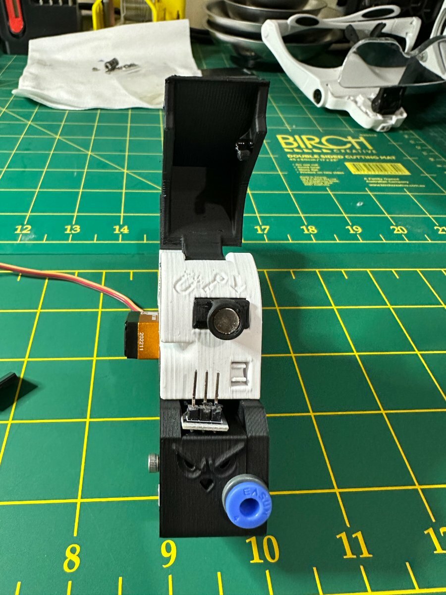

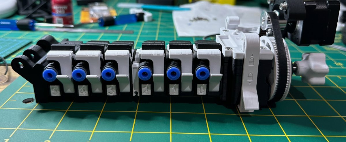

Build Manual Page 42 - 55 Selector

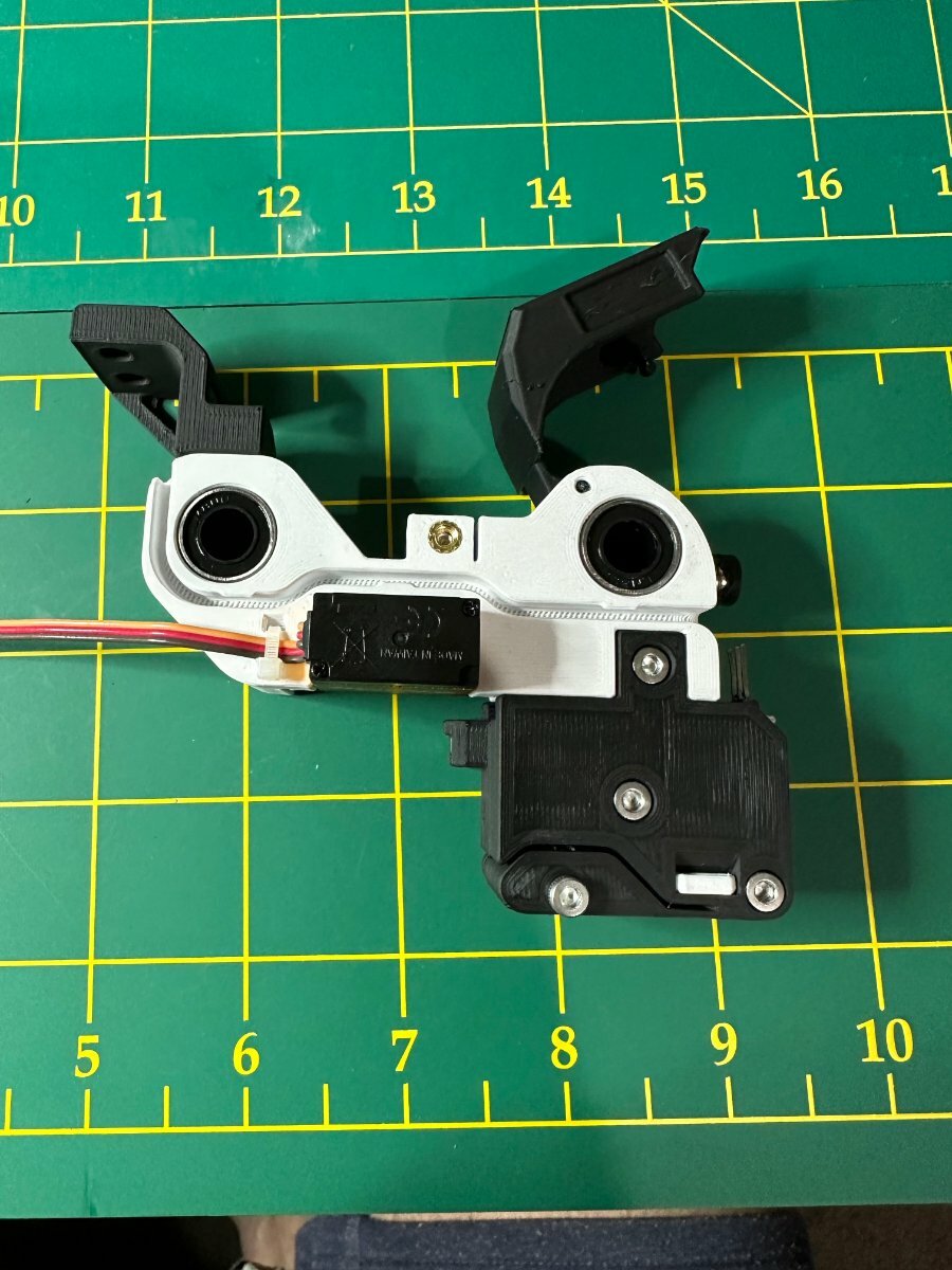

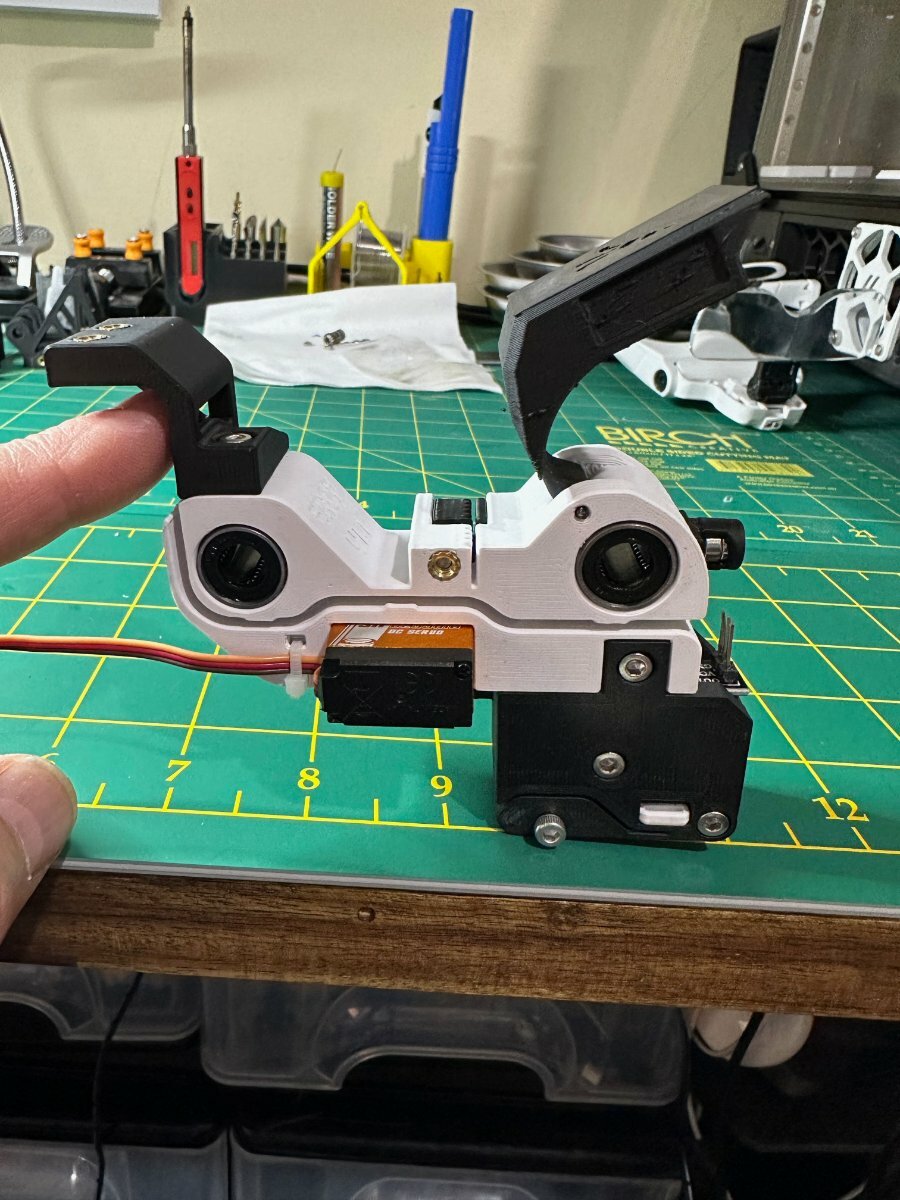

A couple of tips for this section:
1. If you are going to install the SAVOX servo, then you would need the SAVOX Adaptor.
2. Remember to black out the selector gear with a black felt pen or Matt  Black spray and then shine the edges of the gear with 2000grid sandpaper
The end product:
IMG_4005.thumb.jpeg.5f2b39b4fe756873f11b0919b23906c0.jpeg          IMG_4006.thumb.jpeg.9d9f461acba0556d1bf5935d26b4bc7d.jpeg       IMG_4008.thumb.jpeg.1cebb62b40fc6c0708c0f5cba85c12f3.jpeg
Next --- Linear Axis
EDIT: Just realised the TRCT sensor board is mounted on an angle - will correct that

The optical sensor has been know to play up due to the reflection of the gear. By blackening out the gear you improve the reliable and thus accuracy of the sensor.
This probably does a better job of describing it then I can.
"By blackening the gear troughs and polishing the top surfaces of the gears you are establishing a consistent set of surfaces for reflections. This method works well when the adjustment of the sensor is HIGHER than originally intended i.e. further away from gear. This is because if it is too close the plastic separator between the IR led and phototransistor will impede reflections."

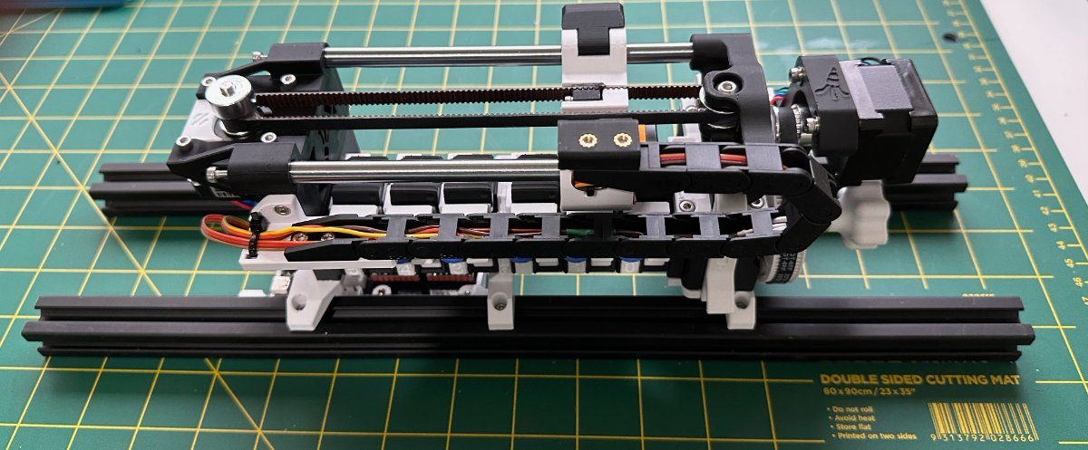

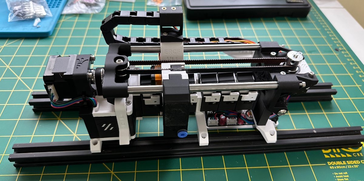

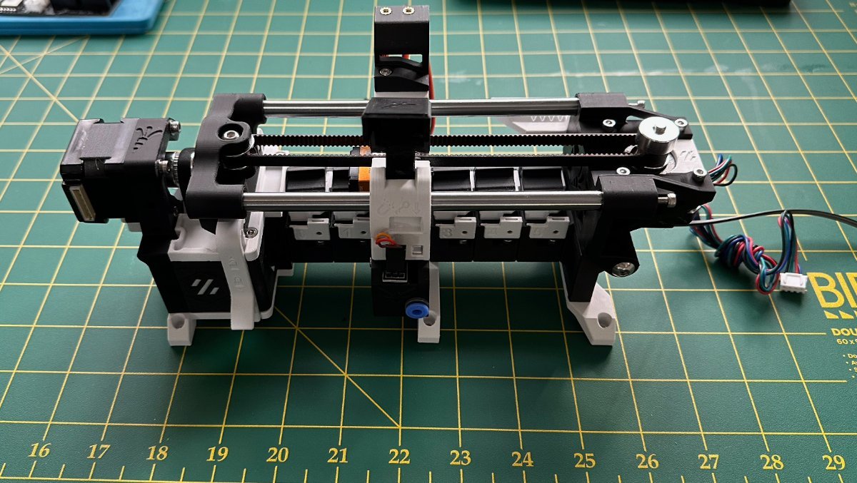

Build Manual P56 - 63 Linear Rails:
The majority of the build is now complete. Some wiring to be done, then on to the Final Assembly. Then I believe the hard work starts - calibrating and programming this thing.
IMG_4043.thumb.jpeg.5a86d717e2783030df7d93d286c5844a.jpegIMG_4042.thumb.jpeg.12e9ad5c3e0ba51799a02fad9e5ea2b6.jpeg

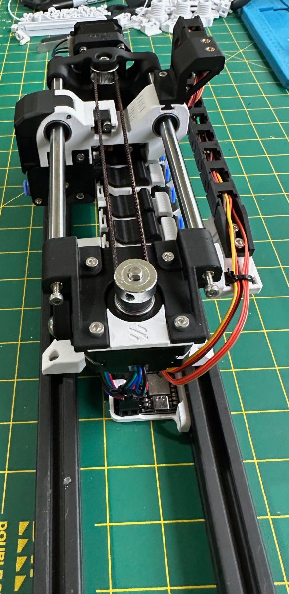

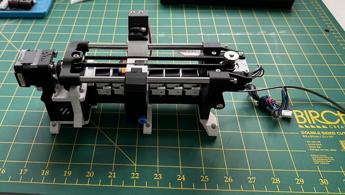

Build Manual Pagers 78 - 85 ERCF Easy Brd
Wiring done, crimping done and temporarily mounted on some extrusions (just to get the wire length) Unfortunately my servo wired were on the short side and this determined the position of mounting the ERCF.
I am planning on mounting this on top of the Printer using the Top Handle mod. Waiting for the extrusions to arrive to mount on printer. IMG_4046.thumb.jpeg.a41d5d8e428d6737d52115e451d61406.jpeg      IMG_4045.thumb.jpeg.0dc12fcde75c081811dc9173458429f3.jpeg   IMG_4047.thumb.jpeg.9bc2cd4f60b6c9b483505285acb45c1d.jpeg
Next ERCF Easy Brd Software installation

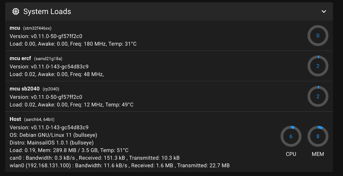

Build manual Pages 88 -  91     ECRF on Klipper
Skipped this section in the manual and moved on to Happy Hare (ERCF Software V3)
Only confusion during the installation, was asked if the build included a selector bypass - I reread that section of the manual and couldn’t find any reference to it, so I said No - Lets see what happens.
The Happy Hare v3 software does it all for you - all the necessary config files are created and changes to klipper.cfg are made to include these. Be sure to comment out the client_macros.cfg file if you already have these macros, or comment out the existing ones. (Park, Cancel_Print, Resume and Pause)
Restarted clipper and ERCF mcu has loaded successfully.

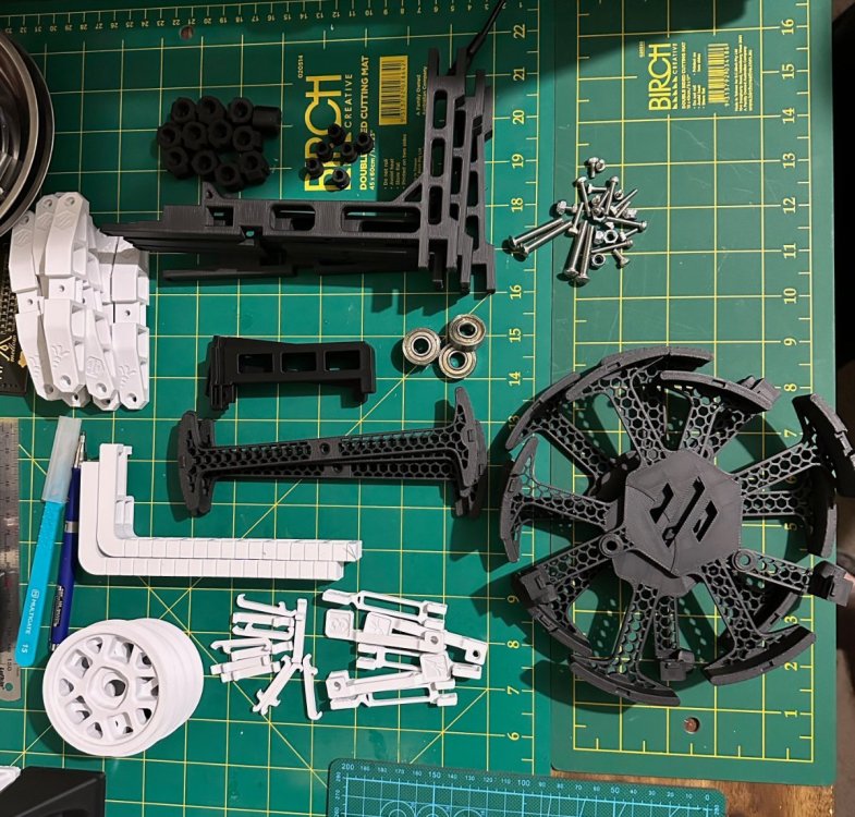

Carrot Patch Manual Page 1-3 Carott Patch v1.1 assembly.
All parts printed and hardware set out for 4 patches. The other two will be printed hopefully tomorrow. (Cannot print through the night at the moment due to some illness in the house)
