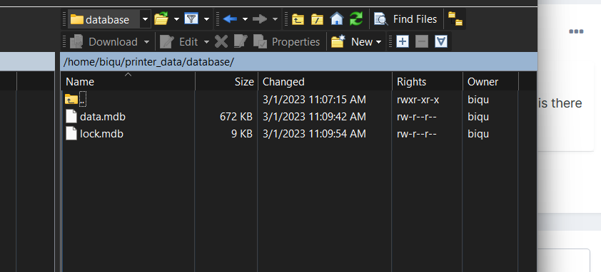

Nevermind.  I figured it out by randomly coping the files that seemed most likely, in order from most likely to least likely, from the OrangePi Moonraker folder over to my CB1 Moonraker Folder.  It finally worked when I got to the folder below.
In case anyone in the future is searching, with the same question.  Copy these two files from your old system to your new system.  /home/yourusername/printer_data/database
Replace the data.mdb and lock.mdb files in your new system, with the files from your old system.

But yes, presuming you're using something like Mainsail with Moonraker, then Moonraker has a database you should be able to copy across - exactly like you did
After moving the files over, my update manage showed red errors for everything, but after rebooting the CB1, it seems to have resolved itself.  Everything is working as it should.

As a *nix admin I would think you should shutdown the DB and only copy the data file. The lock should be generated when the db is started again. But if it worked who can argue with that.
