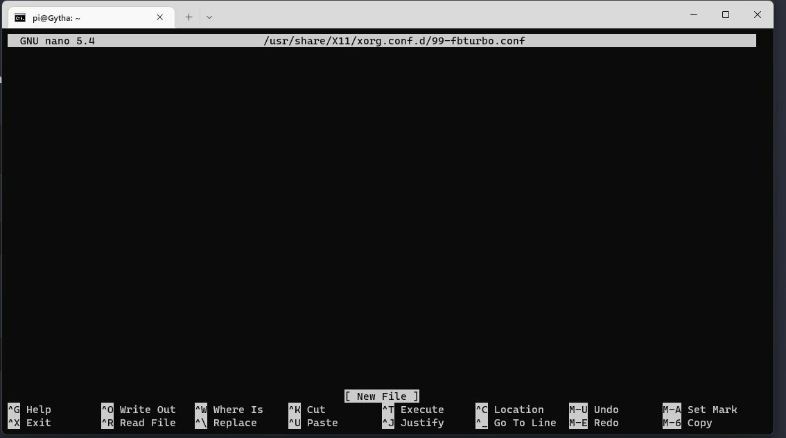

The other command, nano /usr/share/X11/xorg.conf.d/99-fturbo.conf will make the file if it isn't there. In the screenshot you sent, you are inside of Nano (the text editor). You just need to type in the /dev/fb0 part and exit/save the file.

ls /dev/fb* should return /dev/fb0 or /dev/fb1 (or both or more)
You need to add one of them to the 99-fbturbo.conf file to tell Klipper Screen which output to use. Then use [ctrl]+[X] to exit the file and select "Y" to save the file. If the first one doesn't work then edit the file again with the other value.

Thanks for the reply, when I run that command I get the following:
ls /dev/fb0
When I this command - cat /usr/share/X11/xorg.conf.d/99-fbturbo.conf | grep /dev/fb
It says that there is no such file or directory. Is that why the following GUI screen is blank? Do I need to create the directory before I can add in anything? I'm a newbie when it comes to this...
We were all there once. It looks more daunting than it is, once you figure out the basics it gets easier.
IT WORKED! Thank you so much, this has been annoying the hell out of me for days now! 😀
